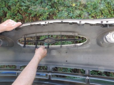

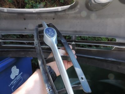

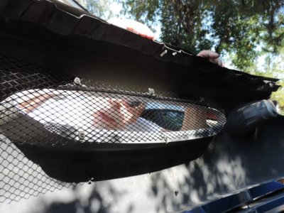

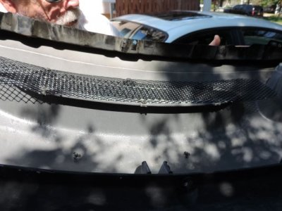

I just realized I did this to my Gen3 SHO but never posted anything about it. Vestin112 posted this for his Gen4, so I thought I'd put one up. Pretty straightforward. Just remove the bumper, undo the screws that hold the old one in, and make a mesh replacement (mine was from Home Depot I think, rain gutter tops or something)
