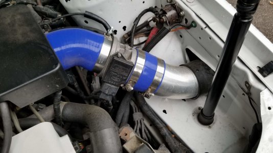

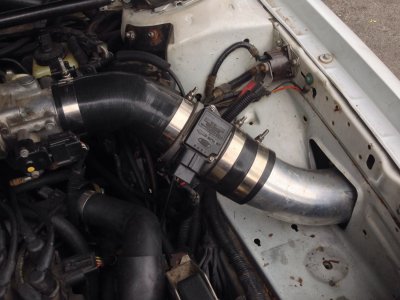

The factory air box is already a Cold Air Intake. A pretty good one too. Anything done to remove that is purely for looks in my opinion. That being said, this is what I made for my 91+. Its just some 3.5" tubing with silicone couplers. I've modified it a little more since I took this photo but the idea is still the same. I can post an updated photo later today. If you decide to go this route let me know and I can post the K&N filter # that you will need. I have it saved in my phone. There was someone selling a SHO Shop fender mount in the classified section. You might poke in there to see if its still available.

Thanks Irish
Much appreciated.
Now does that ****** bolt up to the inside body well? Or does it fit snug and is held there form the ridged CAI tubing. I like it I just want things to work,fit right and look semi good lol
I think I will be going this route as I just scored some spare CAI tubing from my uncle. I'm gonna do some measurements and some brainstorming then pull the trigger.
Maybe if you could let me know the route you took and how you mapped it out filter tuber size pics etc... that would help me pinpoint and execute.
Much appretiated
thanks again

K&N #RC-3180
3" silicone elbow from TB to MAF
3.5" silicone coupler from MAF to pipe.
3.5" pipe to mount filter.
The elbow length and angle will depend on the angle pipe you use. You better have solid motor mounts to do it my way or you'll risk popping a hose off. If you don't have solid motor mounts then you'll want a 3.5" **** hose from the MAF to pipe. That will give you some play. My IAT sensor is mounted in the underside of the elbow right before the TB.

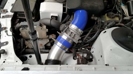

My current CAI. My old coupler is now a bushing on the pipe where it comes thru the fender.

This is really awesome Irish thank you
And the paint job looks great.
That's also another thing I am working on is spit shining the whole engine compartment.
I think I'm going to try and spackle paint my pipes with some hi heat textured black paint.
My CAI in my 95 Impala SS is like that and it looks pretty good.
Question. So have the CAI do you notice a big dirfference in performance? Sound? I mean I know there is not much a difference is thought I'd ask your opinion in what you think of it once you installed it and gave er a rip.
Super appretiated
And awesome work looks really good
I'll have to pick your brain on the paint tip once I'm at the stage.
I'll put some pics up once I'm at my car and moving things along.
