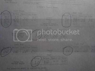

Also, post up the alignment sheet if you can.
The first sheet is what I handed the alignment tech and told him these specs were desirable for me.
IMG 20130204 102556
And this is the closest he could get it, I was satisfied but maybe I'm missing something here. I know that is a lot of positive caster but since I have adjustable mounts I figured I should get as much as I could from them.
IMG 20130204 102543
-josh

I thought 92s had VAPS?
They don't.
The alignment setting are even, which is good I suppose. I think cars are set up to have different caster on the left and right sides to compensate for the crown of the road...yours is equal, which is probably why it pulls some depending on the road.
That was the idea, I mean I was under the impression that you only needed .1 to .2 degrees difference right to left to compensate for road crown. That's why I was happy with -0.1 degrees cross caster.

I doubt you'd notice the difference with only a couple of tenths cross caster change, that is a perfectly fine alignment you have right there. I will say that having positive toe in the front changes the feel of the steering a lot, helps counteract the tire wear but it responds to turning a lot better with the toe more negative as per ford's spec.

I preferred positive toe for more straight line stability, the cost of turn in response is probably negligible considering my other issues and that fact that this is more than a 20 year old design.
