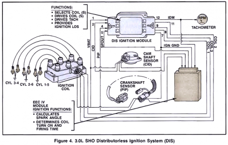

This^^^. Do you have any problems with it starting? My cam sensor was bad so it wouldn't start sometimes. When it did half the time the tach wouldn't work. Might be a problem with your DIS module too.

Could the Cam Shaft Sensor (CID or PIP) be dirty, oiled up, or faulty maybe?
- Would that cause the miss?
- Would it cause the TACH to read weird?
