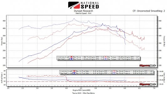

Mods in signature MINUS the Downpipes....not installed yet. These were done on the same day in a temperature controlled room.
Video of the First Pull:
View attachment 8440 View attachment 8441
I like the gearhead tune. What's up with the a/f ratio on the livernois? I like the steady a/f of the gearhead. Not that I know anything.

LMS doesn't lock the gears in sport mode.. so we couldn't go WOT until close to 4K rpms or it will start to downshift to second gear.. thus why the enrichment looks funky.. Unfortunately I called LMS several times and a day or so before the dyno was scheduled to inquire about their recommended way to run their tune on a dyno. I was aware of this issue before hand so was hoping to mitigate it before. You can see the blue line has an artificial spike at around 3500rpms because it started to down shift but he was able to ease off the throttle intime..
They have to have a preferred method or they send a tune that can lock the gears in place with the paddle shifter.. looking at their dynos, it appears they don't have this issue. It makes comparing the torque under 4000rpms impossible as its not WOT from that point backwards.
