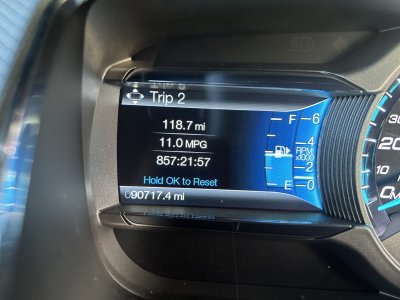

So I went into the trip counter today to reset it and I saw the following info. It’s kind of what I thought. I was getting 11 miles to the gallon. I didn’t even think to look at the trip setting IMG 0579because I didn’t know calculated MPG.

Thats really low mpg for that many hours. Unless its a ton of idle. Even when i blew my engine it still got 15mpg. From my experience these engines get better mpg when tuned. Even with a lead foot. I did notice a good bit more mpg when switching to AJP Turbo years ago compared to my Livernois tune. And the Livernois tune was alittle better than factory but at the same time i had my first free flowing intake and full catless exhaust. So that probably helped. Engines are air pumps and turbos increase efficiency when cruising by breathing for the engine instead of it needing vaccum yada yada.

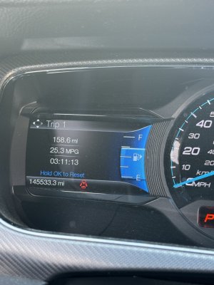

Took a little drive down the highway yesterday. Was around 26mpg on the highway till i got off and played in the Appalachian mountains on a backroad home.
