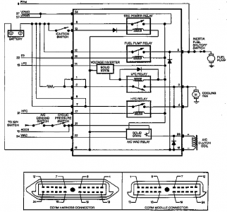

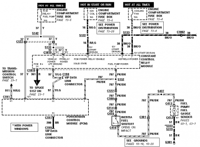

I can't picture the scenario where this would cause the symptom, but you could ensure all three power sources and 5 power pins are supplied as depicted (this is for 1993 ATX since I don't know what tranny you have):
96FZqlY
OUN22Nu
96FZqlY
OUN22Nu
Thank you .I have a manual transmission. As usual nothing is constant with this car. Now for 2 days the FP is shutting off like its suppose to so will keep an ear out for it for now till it acts up again. Plumber
