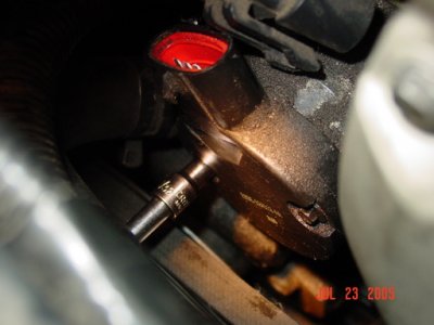

The cam sensor is not something you need to hire a mechanic for - in fact it's a lot less work than you might think, just helpful to have small hands.
Unplug two connectors to the DIS module mounted to the passenger side of the engine , remove two 12mm bolts and loosen two clamps, and pull off the crossover tube on the side of the engine the DIS module mounts to. You can now see the black round cam sensor on the back top of the engine. Unplug it, unbolt two bolts, and pull it straight out.
There's also a trick the MTX owner might use, which is to go in through the wheel well where there's a hole in the strut tower housing:
DSC01072
for the MTX method:
1/4'' Drive Ratchet
1/4'' Extensions (at a minimum, 2-3 4'' units; the pics will explain)
1/4'' 5/32'' socket
1/4'' swivel
otherwise just the socket and a little 1/4" ratchet. The crossover tube bolts are 12mm.
