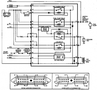

The common power for fuel injectors and some fuel control inputs is supplied by pin 24 of the IRCM (CCRM), which may be defeated by anti-theft interruption of this output, or input of ignition key-on power to pin 13, or battery + or -.

If there is fuel at the rails, but no fuel getting into the cylinders, then either the injectors are not opening or the injectors are not being fired. Since your report is that there is no sign of life until starting fluid/carb cleaner is used, that suggests that the injectors are not being fired.
Is there an anti-theft device on this vehicle? This generation of anti-theft typically let the engine crank but shut off fuel.
Any prior issues suggesting the pcm is sick? These units are 25+ years old now, and do have some failures.
