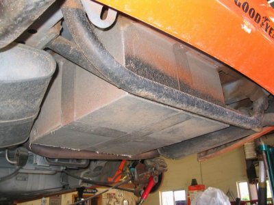

Here's a pic of the installation on the Bondurant cars:
Fuel cell
Roush installed these and the location may not have been driven by performance considerations (as Tom mentioned, it helps maximize the polar moment of inertia, which is not a good thing for handling). I suspect that they were put where they are because Bondurant used the back seat in the cars and they wanted a way to completely isolate the cabin from the fuel cell. Where you see it is about the only place you can put a fuel cell and achieve that.
IIRC Dan Brabec, the guy that races a SHO in USTCC, put a small-ish fuel cell in his car just behind where the back of the rear seat would be. That's higher than the Bondurant location, but further forward.
It's a real compromise. I suspect that the rear location of the fuel cell is part of the handling problem issues I have with the Pumpkin, but I don't know that for certain. I do get better rear tire temps than I used to on the silver car, but I'm still suspicious of the thing.

That's just there to protect the fuel cell and is a safety requirement under some rule sets for a fuel cell located like that. Adds even more weight. :cry:
