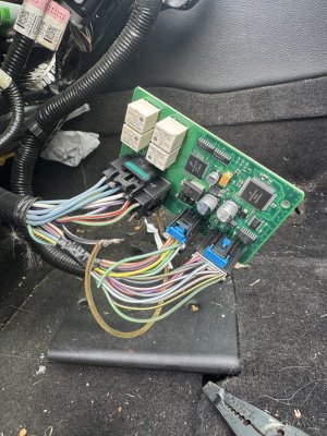

Bought a cheap aftermarket controller for now with intentions of fixing the old one. Till I took it apart and found out why it didn’t work. May still fix it. Will probably just have my electrical engineer friend jip some wires into it. I’ll keep it updated. Good chances the controller is ok. Currently soldering a wire into it with 1960s lead solder. First time the sho will have lead solder! Lol

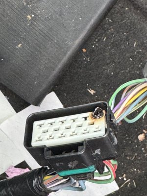

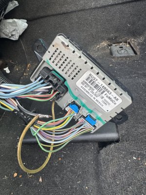

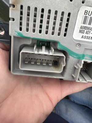

I got it working good. Just have to button it back up with a wire soldered to it. Figured I’d post it so others can see what the internals look like. Taped up the link pretty good and reinstalled. Thank God seat is simple to take out with 4 13mm bolts. So if you need to replace the controller. Take it off first to make sure the wire didn’t get melted to it from corrosion which adds resistance over time. Instead of buying a different controller. IMG 3014
