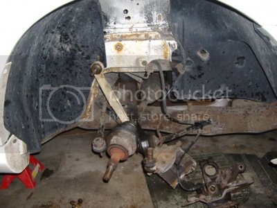

Here's a pic (passengers) when I replaced the front struts... I just want to make sure everyone knows what I'm talking about, the bar thats coming out from the subframe connecting to the control arm. If those bushings are bad (the ones connecting to the control arm), could that cause the clunking?

Yes, and most likely the strut rod reciever in the subframe will need to be welded. See the sticky at the top of this section called "just joined the broken subframe club". Just did this on mine. Started as a clunk over bumps or when turning on an incline then turned into a hideous clunk all the time. Mine completely broke and had to be replaced with the repair kit Moog makes. Good luck.
Is this an easy weld reaching in to the subframe to contact the receiver?

The part you weld is on the outside of the frame. If you pull the nut, washer and bushing from the front you should be able to see the lip of the receiver. It is that lip you will need to weld.
