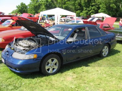

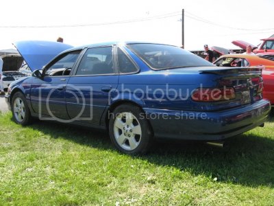

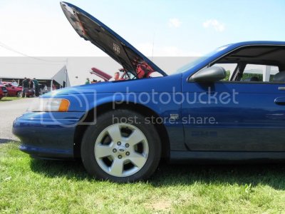

There was a SHO for sale at Carlisle that had a 5x114.3 hub on it. It had some Escape wheels on it I think. I asked him how he did it and all he said was "My stepbrother did it". I told him if he didnt sell the car at Carlisle (I assume he didnt) to post it on SHOforum. It was a VERY Clean 94 ATX for about 2 grand, Hopefully he post's it up soon.
-Sam
Yea I talked to this guy too. He gave me the same answer, so I kept prodding...
"Well, so how'd he do it?"
"Well he just swapped the other hubs on there"
"that's it, just swapped hubs?"
"Yea"
Sounds to good to be true.
Anyway, I must say the escape wheels looked good on the gen 2. I took a few pictures too

I also mentioned SHOForum to all three of the guys sellin SHOs. That red '90 was in GREAT shape, plus the Mille Mags, which he was clueless on so I filled him in. The original wheels were in the trunk, the owner popped it and show'd'm, black basketweaves with silver lip - they were in good shape too. Unfortunately, he was asking way to much for the car.

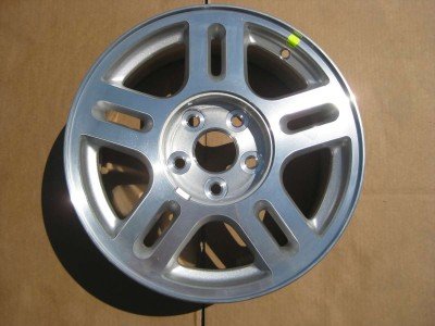

Those are actually Freestar wheels on that SHO.
Thats what I was going to say. They do look similar to a certain style of Escape wheels.

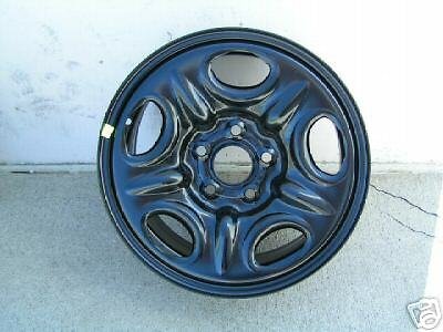

If I did end up figuring out how to do all this, I would have gone with either of these wheels-
This one for the police look/winter wheels:
3665 1
Or this one for stock winter wheels. ****, my centercap off my wheels will fit these:
