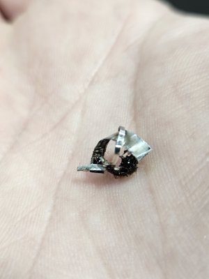

Getting the oil pan replaced and some metal was found stuck in the oil pickup :confused: Where do you guys think it came from? No engine noise.

That kinda looks like a part of one of those little oil filters that be on the VCT solenoids. Or on the rear turbo oil feed banjo bolt there is a little wire mesh filter. Kinda looks like that. Have you had or did you do any work to the car recently?

I had the water pump and timing chain done almost a year ago.
