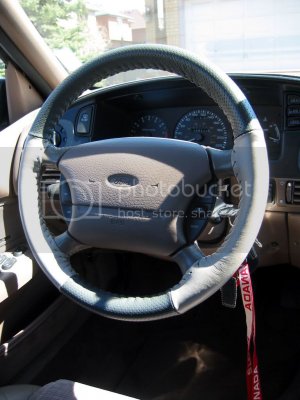

I've done 3 of them using the baseball stitch method (it'll look and feel better) and I've always finished with a quite a bit of excess threads at the end, so 1 thread kit is enough.
It can be a pain to put on, but the results are worth it, it's a great product. Remember to wear work gloves when you're pulling the twine tight (and you want it to be tight, especially around the spokes so you don't see a gap), or you're going to **** your hand in the process.
