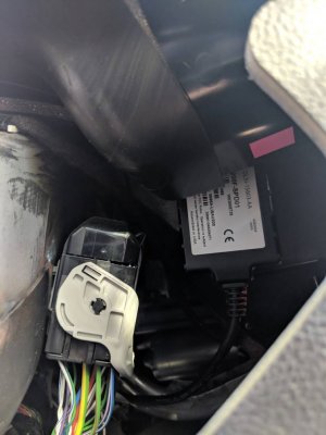

jmr061....good question. Something tells me it does....I'll have to pull that lower panel or look up from the footwell in the AM. Should it be lit at all times?
Looking at xFallen's pics....the bottom pic....mine is taped to the flat metal panel, around where the three welds are visible.
Thanks for posting the pics....I didn't realize that side panel popped off....I worked from below.

It does have a status light mine blinks Amber normally

Looking at your pics....the bottom pic....mine is taped to the flat metal panel, around where the three welds are visible.

I can see from your pic that the LED is orange which is a good thing. My bad on the pic, thought that was yours. Still need to check the LED. If it is off, that would mean either it is asleep or not working. You mentioned its mounted on metal? If so, not really an ideal spot.

I will also move to a different location (like shown in the pic) as opposed to on the metal...

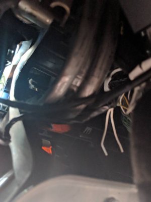

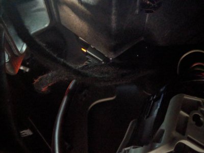

An update. I'm moving the SIM/Antenna thing to where FallenX suggests, but cannot find any sort of a status LED on this unit. I only see a small hole near where the wire harness goes into the box. IMG 5449 IMG 5450 I've attached a couple pics.
Today, I am getting the 20002 error, (or 11000) about not being able to connect to the server...still wondering if it has anything to do with my subscription having some sort of issue...

An update. I'm moving the SIM/Antenna thing to where FallenX suggests, but cannot find any sort of a status LED on this unit. I only see a small hole near where the wire harness goes into the box. View attachment 6964 View attachment 6965 I've attached a couple pics.
That bottom hole is where the light should be Df43a200311dd025d96d74aacbb5db13E0e0e0c30b66ce5baca202abdec8e867

Thanks....I don't see it lighting at all. Looks like everything is still plugged in...very strange
