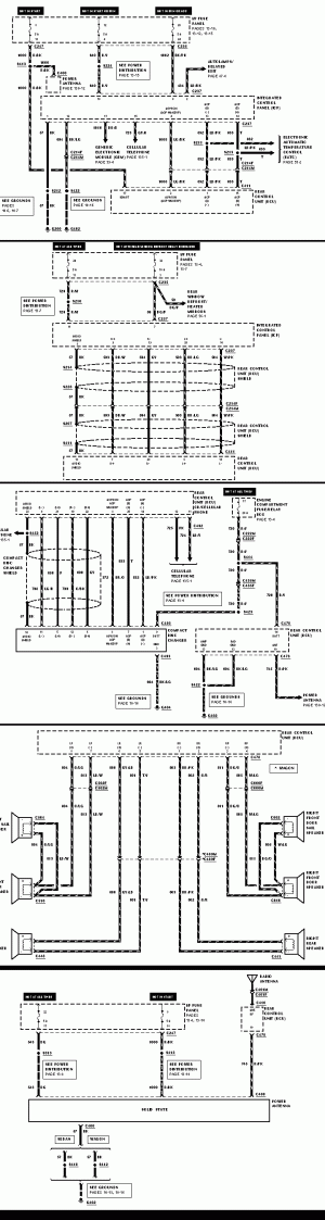

So...I bought another radio replacement from E-bay. That unit also does not work. The AC controls work and it lights up. I put the replacement in a buddy's 99 Taurus SHO and it works in his car. At this point I am kind of stumped. The only other thing it could be is the radio control module in the trunk. Does anyone have any other ideas. I checked the fuses, under the dash and under the hood, again and they all look fine. Are there any other fuses that I am not looking at? Does anyone have the fuse diagram for the radio? Does anyone have spare radio control module (trunk) for a 98 SHO or will one from a 96 SHO work?
Thank you all again for the advice and tips :)

Slight update: I took SHOZ123's advice and checked the power going to the amp. So...I did the test and there is power going to the amp. When I plug everything back into the amp I hear a "click" sound coming from the speakers. I look at my radio the clock is on and when I hit the power button the antenna went up and there was sweet static coming form the speakers. I was praising the SHO gods...ISSUE RESOLVED... :p
I even called up a dealer buddy of mine in Washington and he seemed to think that it was a power issue. He claims that these amps very rarely go bad and a new would cost a little over $350.00!!! I am glad it wasn't the football radio...I would have hated to replace the one I have now (It has a carbon fiber kit on it) or the amp.
So the moral of the story...check all the simple things first before starting to panic and swearing as to why now?!
