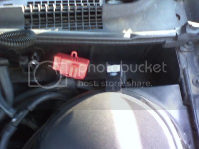

michigan
The fuse block is located behind the driver side strut tower. I have attached a picture for you.

Sacramento, CA
I don't have that fuse block. Mine is a 91 if that matters, I have looked all over and I don't see any other fuse panel except the one under the dash. Here is what I have.

michigan
I would think their has to be one somewhere under your hood. My 2006 Impala SS has one also. Maybe check on the passenger side maybe??
