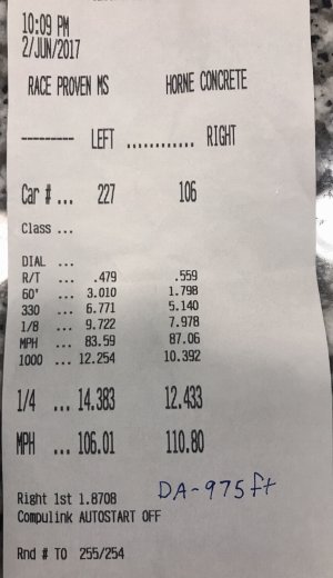

Hey fellow sho owners and tuners, I am wondering what is holding my car back
in the mid range of the 1/4 mile run.. I have been viewing other time slips in the drag
section of this forum and I am right there in the short time 176 and mph of 109 to 111
and all I can do 12.61.. I am wondering if the exhaust is holding the car back.. I do have catted
dp's to a stock system.. Any input would be appreciated .. Thanks..

Yes that is what I am wondering... I see time slips comparable to mine and there 2 tenths faster.. Just thinking if there is back pressure in the mid
range not letting the car breathe.. This past Sunday went to island for a last shot to get a 12.50 slip.. The air was cool and crisp little over cast don't know
the da probably few hundred above and the best I could get 12.64 176 sixty at 111.15 something is missing..

Stock exhaust here, front to back... [email protected].. who tunes your car?
Those are some great ET'S... It seams that most of the low et guy's don't have stock exhaust from the cats back
except for steelgiant.. I am trying to post a time slip so we can compare..

I come from racing old school carb cars and there not that much variation in time slips.. When
you have a 176 sixty and go 111.15 and the next run is a 183 sixty at 109.51 and go faster something isn't right.. The computer is taking timing out I guess..
