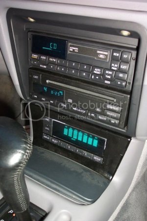

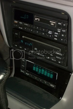

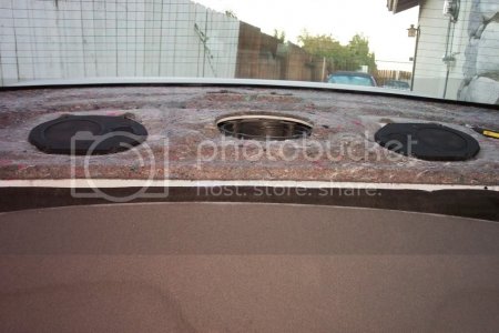

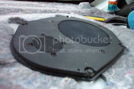

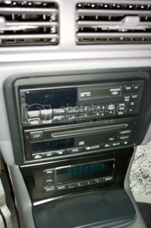

Finally got the eq added to my 95. Also added the two way design ford jbl speakers from a thunderbird, to the rear seat in my sho. For anyone who has seen a factory jbl rear seat taurus speaker, you'll know they are a single way speaker with a tiny magnet. the thunderbird speakers are a nice two way design and are exactly the right size. You'll need to trim the sound proofing, but the drop right in perfectly.

Those look very similar/same as the front speakers from my '97 Explorer with JBL.

They probably are. It seems like all the JBL stuff was very interchangeable. I think the town car speakers are very similar too.

Just a quick observation...
I'm almost 100% positive that if you swapped the front 6x8s to the rear and put the 2 ways up front you'd get much better sound overall. Then again, I've got 4 speakers mounted up front with absolutely no rear fill and am convinced that you wouldn't be able to tell unless you were trying to.
