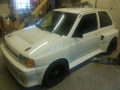

Well since we won't get the build thread for a while, the least you can give us is a teaser pic! (or ten)

Missing the tuning , some gremelins like my belt is squeeking , rpm is fked , fans wont turn on...etc little stuff.

Its evaluated at 40k. I also need to redo some wet sanding and rebuffing in some spots. Missing decals , but i have them, exact replicas.
