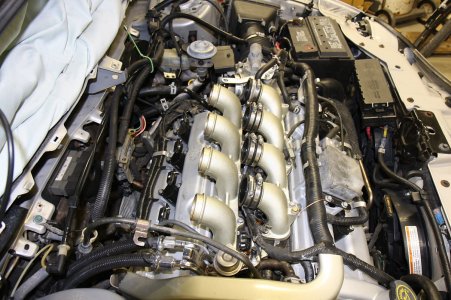

Hi,
Not trying to hijack the thread…if you are asking me about the wires;
They looked fine when I got the car a year ago. I looked pretty carefully but now I’m starting to doubt myself. I saw no damage or repairs to the original wires but the loom was getting ratty…so I rewrapped it. I’m just buttoning it back together today, looked one more time for something obvious or even semi obvious.
This is the current appearance/condition
Showire
the miss is so similar to all descriptions that I believe it is ignition or fuel injection and the difference from time to time has to do with the computer trying to handle the situation. If I add a can of red line fuel cleaner I can set a code….bank one rich…so either the ignition isn’t up to ***** or maybe an injector is clogged open just a bit (you would think the 5 cans of red line would have handled that) …maybe the pintle or whatever is inside is damaged.
