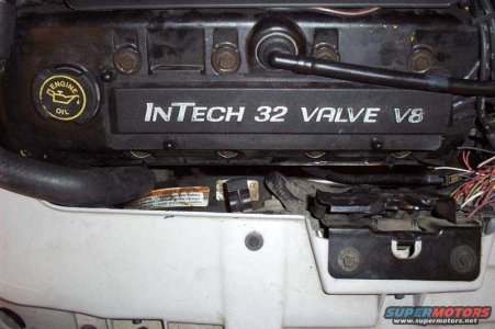

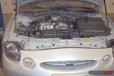

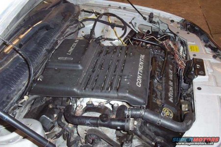

I don't think the TCCA guy ever drove the car either or got it running.
46l in a taurus 2
46l in a taurus 3
46l in a taurus 4
46l in a taurus
46vs50
hawkeye18
Sorta cares
May 18, 2004
5,631
2,727
Norfolk, VA
DOHC engines kind of by definition are huge pigs. If you're going to swap a motor, you might as well drop a SBC in there and call it a day.
jmpSHO2nd
Jul 21, 2010
645
147
Massachusetts
Damn that thing looks crammed in there, after seeing that I would definately not go that route. I would just find another 3.4.
