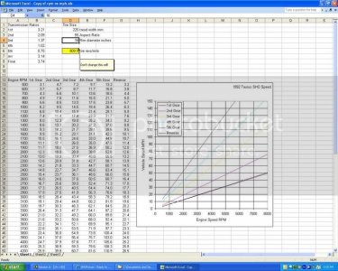

This is for an MTX but you can still translate. I also have the spreadsheet so I can punch in differeng gear ratios and tire sizes.
For you, I think third gear (overdrive off) will be damn near 1:1
225 55 16
