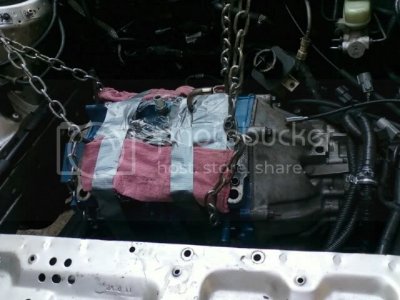

Top for me while leaving the transmission in the car. Usually pull the heads off first before taking it out and just put the shortblock back in and install them after. Makes installing it much easier plus the motor mounts are all accessible from the top as well.

Here's a pic for reference. This is the shortblock going in. Leaving the heads off makes it easier to get the flywheel aligned to the input shaft of the transmission and also to prevent damage to anything on the firewall.

Might be easier to pull it out with an MTX attached, it isn't THAT bulky. Plus the weight that it has will throw the balance off and allow you to get it up and out. I haven't gotten to the reinstall part yet, though.

Leaving the MTX in means that none of the axles or suspension needs to be touched. I made sure to prop it up with blocks though when the engine was out just to keep as much stress off the mount as possible.
