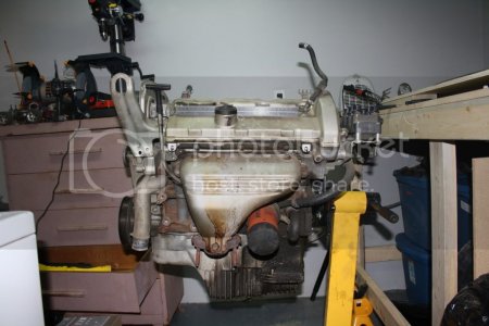

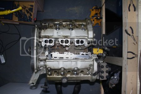

No pilot bearings on either, but there is a recess in the crank for one. People that need them usually use bushings rather than bearings, it's easy to get a custom bushing made. I have some pictures of an engine with a ruler I will upload later.

Not the best, but maybe you or someone else can use them:
IMG 2753 1
IMG 2767 1
IMG 2750 1
That's a 15" ruler in every shot, you should be able to dimension things with that.

when I measure the engine, I get
25" wide across the heads, 28" wide at extreme of exhaust manifolds.
27" tall from bottom of pan to top of throttle body.
21" long from trans mounting surface to furthest pulley (atx configuration) and 24" long to the back of the left head.
