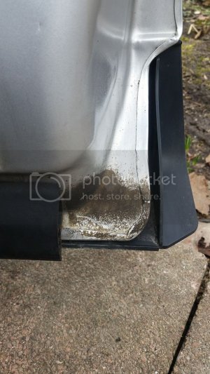

^ That's it. Second season cleaning mine off. I looked under the car and has under coating also. Must have got the whole package. Hope it helps the underside. This is my 2004 taurus wagon purchased new. Photo from November.
Floor board passenger side.
mmh64
Feb 29, 2016
123
88
crown point indiana
It was quality 12 years ago when I bought it. A lot of sheet metal ,rivits ,spot welds screws,and undercoating. It's good as new again. Talk about bad pinch welds. Those jack points on the wagon are virtually non existent now. Gotta love rust.
