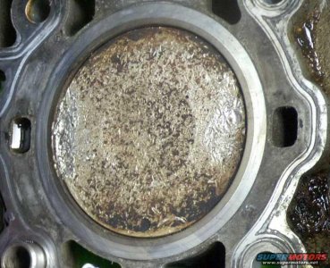

Yes those good times. Like the time I dropped a small washer into the #1 and didn't notice until start up. :(
No 1 piston tdc closeNo 1 cyl head
gamefanatic
Feb 20, 2005
790
288
Barstow, CA
do i need to drop the engine out to pull the head off
Nope. Heads come off in-car so long as you can reach it.
They have magnetic and claw snakes at most automotive places that could get in there.
A wire close hanger or a stripped back copper wire could also work in a pinch.
13,265
If the piston is in there it should be a drop into the cylinder filled with the piston. Get enough of a strong vacuum with hose in there should suck it out. Even if the hose diameter won't take it inside it should stick to the opening.

in the process of fixing it today I dropped the heliecoil into the cylinder.
Filling out this picture a little bit so we can understand the challenge a little better.
Were you threading in the Helicoil when it fell in?
In other words, did you turn it in too far, it unthreaded to the inside and dropped into the cylinder?
If that is the case, then the Helicoil is actually larger than the hole at this point and you CAN'T pull it out, you could only reverse realign it and thread it back out backwards. That would be an amazing magic trick!
If that is the case = head comes off is only solution.
