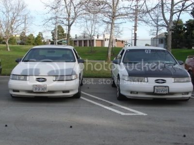

DSC00418
Mine on the left with Koni/Eibachs and stock slicers. Matt's (LoudSHO92) Koni/Intrax w/17s on the right. Does mine seem lower than usual for an Eibach setup?
Another:
SHO Continental
Moderator
Nov 28, 2004
2,111
501
Northridge, Cali
Sean having a heavier ATX makes it a tad lower, also when I got my c/f hood it raised the front about a half inch. So the comparison to matt's MTX with c/f hood is kinda off.. ;)

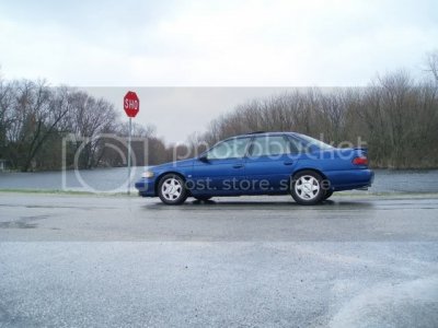

Stock
P5010371
Intrax, 1 coil cut up front

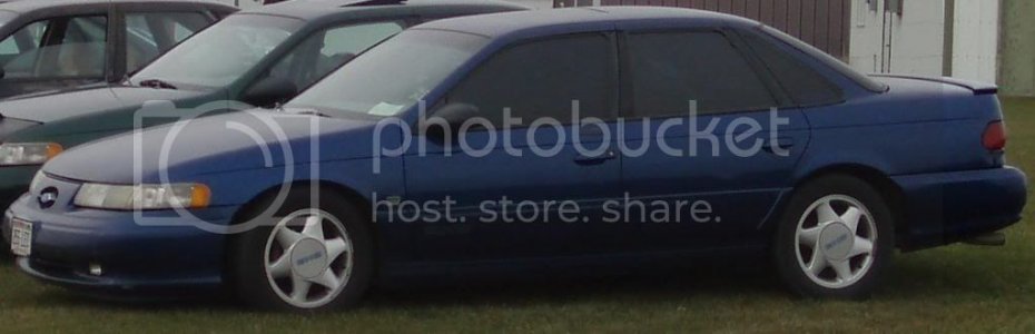

This one shows the stance better (not on grass/hill)
Shostop
In my opinion if I had an ATX I would NOT cut a coil the MTX is lighter and sits higher
