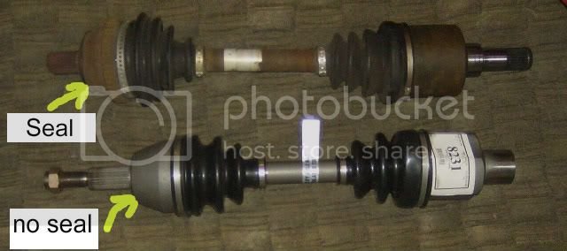

It's attached to the axle...if you replace the axle there should be a new seal. If not, you would have to transfer the seal from the old axle.
Here's a pic...
Shoaxles
It should still be on your axle...so don't worry too much...

the picture above shows an ABS axle from a MTX car and a non-ABS axle from an ATX.
The ABS ring is not part of the dust shield...it IS just a ring....like you said.
