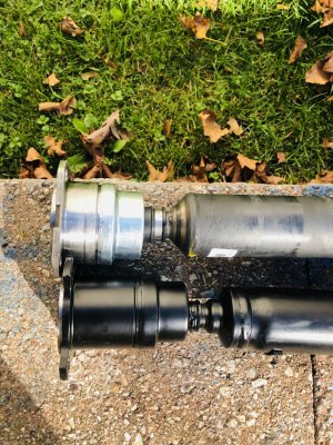

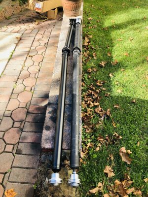

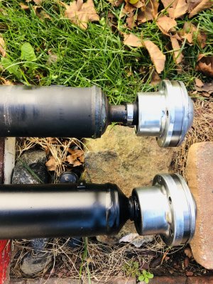

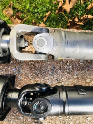

I have a 2010PP with coilovers, upgraded TC, Stage 4plus LMS tune and have a vibration between 40 and 70 under torque but not free wheeling. I lifted the car up today and looked at that carrier bearing on the propeller shaft just before the universal joint and it is a loosey goose!!!! I track this car and don't want a high speed failure so I'm installing a whole new drive shaft that sits between the PTU and RDU with new carrier bearing. Nip this **** in the bud!
ticoscen
Nov 18, 2015
165
80
DORMAN makes the best propeller shaft replacement. It is upgraded and built to order. U joint and carrier bearing is serviceable and replaceable. OE Upgrade it's called.
ticoscen
Nov 18, 2015
165
80
The black unit is the chinese made unit "Cardone". It may work but the front CV joint is elongated and looks smaller. I settled on the DORMAN because they make the best propeller shaft replacement for the SHO. DORMAN is US built to order, upgraded and balanced. U joint and carrier bearing is serviceable and replaceable as are the front and rear CV joints. OE Upgrade it's called. I spent alot of time researching all this because FORD has a 6 month backlog on rear shafts and 300 units on back order.

So far so good! Car is smooth all though the speed range now. I have confidence is this propeller shaft design too.
ticoscen
Nov 18, 2015
165
80
I'm thinking of adding some 3/8" spacers to reduce the angle of the U joint. Because this shaft has a single U joint at an angle, the shaft can pulse. At 170MPH, that may be enough to vibrate the buttocks out of the carrier bracket and bearing. "Velocity Fluctuation"
