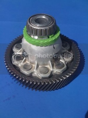

Here's a photo of a differential I serviced:
IMG 0189

Weird. Of all the diffs i pulled apart, the pins were bent like a half moon from the pin trying to come out, not twist.
Far out. All the diff's I have taken apart we're the exact opposite.:shrug:
I've had two differentials that the roll pins came out as you described, which is a very small percentage of the overall roll pins I have removed. This wear is caused by high speeds and quick deceleration, as the roll pin is trying to keep the pinion shaft from ejecting. Either way, bracket welding helps further protect against both of the problems that stress the stock design to failure.
The pinion shafts also have play in them with stock roll pins installed, which help destroy the stock design at a faster rate compared to pinion shafts that are held without any amount of play. By having the pinion shafts welded, all play is eliminated and the holding strength to keep the pinion shafts from ejecting is increased.
And, suppose the welds at the pinion shaft break from extreme twisting force [because the welds will not fail from the "moon shaped" problem], they will be contained within the differential [as your ring style brace does] by the bracket that is welded to the rivet. However, if you produce the extreme twisting force to break the weld, you have a serious problem inside the differential, meaning it's time to replace it with another one.
This is all where the life of the bracket welding differential comes into play, versus your ring style that uses the stock design to contain the pinion shaft. The failure rate with your ring style design is still at the stock rate, as the ring is only there to keep the shaft from ejecting when the roll pin has failed.
