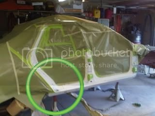

Yes, the term of dog leg is correct, Gen 1 and 2 share same dog leg and rocker panel... I have replaced them before.
This section circled is called dog leg.

The Dog Legs that i have heard of are the lower rear section of the rear door jambs. The sections directly in front of the wheel that tend to rust out in northern cars. If that is what you are referring to then yes, i believe Gen 1 Dog Legs can be used to repair Dog Legs on a Gen 2.

@irishpride... I lol'ed when I seen that we posted same time... It must be the descriptive of pic that trumps your post without pic.. JK! :woo-hoo:
