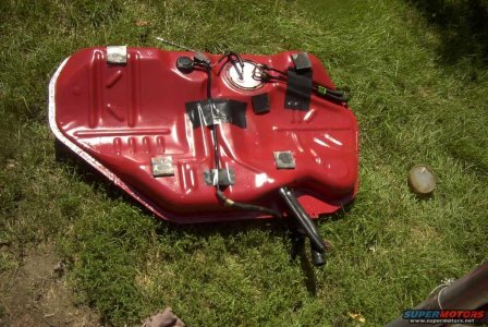

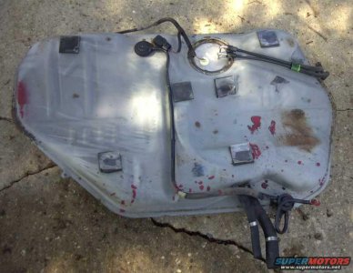

Anyone know what the gas tank looks like? I ask because it could easily be explained that there is more volume of gas at the top of the tank than at the bottom, which would explain why the float in the tank would descend faster.
Any truth to my ramblings?

Hey it was rusty around the seams when I took it down to change the pump. Also had the build sheet on top of it.
Unpainted tank with fittings
