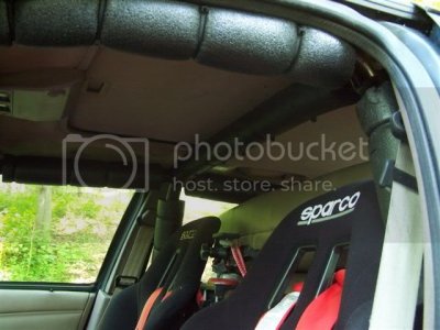

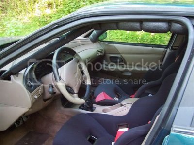

Not sure I have seen any SHO with a full interior with anything more than a 4-point roll bar. Here are some pics of one of my caged SHOs:

that is what i was looking for and that looks sick man!!!!
it should be noted, that this is not a full roll cage, but a roll bar with forward supports.
Tim's car has a full cage.
and I would not recommend using a 'pipe' bender on anything but pipe, if you're building a cage, you use Tube. usually DOM tube.
It should be noted that this is not my car. With that said, I think you are wrong.
It is a full 6 or 8 point cage. No door bars, but with a full interior, this is the best I've seen.
EDIT: If you look, the bars continue behind the main hoop. You cannot see in these pics, but they connect to the rear strut towers.
