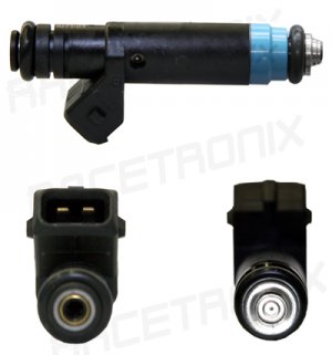

80 lbs should be fun. They're almost as big as what's in my STi, but I'm down 2 cylinders. I need to see if Injector Dynamics makes something that'll fit the SHO.

Doubt it. On E85 those wouldn't be good for much more than 450hp, and then he'd lose "The Challenge" to a stock N/A SHO.
On gas they are good for more like 650hp.
Yup, they do. You can buy anything for a V8 Mustang and remove the adapter caps they have, and they should fit a stock SHO rail. Use them as is for a modded rail. Viper injectors should be the same, and then you'd have 4 left to sell to the 4 banger crowd. I've been keeping my eye out for a cheap set of ID1600s or ID2000s.
I'd be willing to bet that he could get 500whp on E85 and enough torque to put any other SHO torque number to shame by a good bit.
Got a part number? I've already got ID1000's on the STi, wouldn't mind some ID750's on the SHO since this lower altitude has maxed out my 48's and I imagine the new changes will push it further. I am already planning on bumping up to a DeatchWerks 300lph pump.

I was looking at ID1000 for my camaro project. Do you guys know which one fits the SHO? I think there is 2 different sizes
