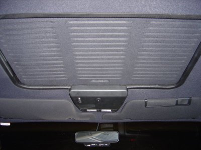

The shop quoted me $150 today to do just the headliner (and I will remove the louvered shade, remove the glue/destroyed material, sand it, and paint it with the Ford titanium paint that I used on my dash cap). I'm going to let them do the headliner for that price. I can handle doing the sunroof shade. The guy told me it'd be best to remove the material down to the plastic and just paint it. They've tried covering those louvered shades on other cars with very thin material, and he said it's a PITA and often doesn't work well/look right.
Here is my louvered sun shade I recovered years ago. It still looks new today.
New20sun20shade

I have the shade out and my project this week is to strip it and paint it. Which would do the job better to strip it--acetone or the lacquer thinner? I figure I can use a paint scraper to get all the material off. I just don't want to weaken/ruin the plastic with any harsh chemicals.
I'm painting it the matching Ford titanium paint I bought from Josh (SHOnut).
Sep 6, 2002
2,351
Westerly, RI
IIRC, soaking it in water works well. I stripped one of mine this way many years ago.
Any kind of solvent on plastic is going to present problems.

I'd say lacquer thinner over acetone, just to get the glue off. You can sand it if you want, but I think the sanding marks will be visible...Then wipe it down with alcohol really well and paint it.
