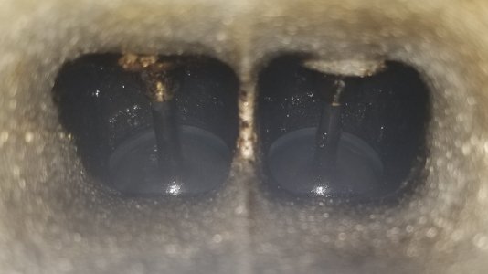

Berrymans is good, seafoam is good. Marvel mystery is good down the spark plug hole. Get a cheap phone inspection camera add on from amazon. And look down the spark plug hole. May not be that bad. Or run light meth. Aem v3 nozzle set to kick on at 8psi. Actually a great investment for any gdi platform. Did you look at your valves with the intake off? They do get bad. I did mine awhile back. Ill find pics.
Before and after, pulled intake manifold. Tried about every cleaner. The best one was crc gdi intake valve and turbo cleaner. Literally burned the carbon off instantly. Its pricey but works best. Carb cleaner didnt even do anything lol.
