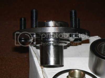

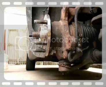

Well, I have about 600 miles on this guy, and in the last 50 I could feel something dragging on that side, so I took the wheel off and this is what I found. Any ideas on this and what could cause early failure? Should I bitch at the shop that pressed it in? Or just autozone for their crappy bearing.
Th P1010404
Now the only thing that isn't perfect on this guy is that I dont have a washer behind the nut because I haven't come across one yet in my J/Y adventures, but I wouldn't think that not being there would cause that would it?

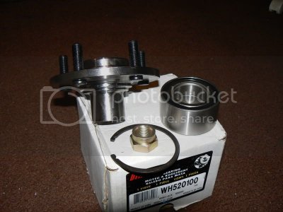

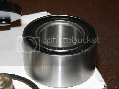

I wouldnt doubt it at all... Here's the bearing with the part number and all. Wouldn't suprise me if its junk. :(
P1000080
P1000081
P1000082
The bearings were the same part number, but I did get them from different stores, so I would imagine they were ran at different times. (eg.. not the same 'lot')
