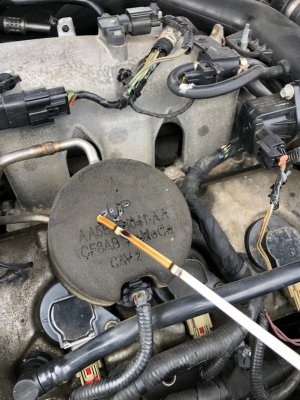

hello everyone keatdog here I purchased a 2010 210k miles haven't seen it yet owner said someone said head gasket smokes like a fraight train but with alot of praying amd my long distance guestimation and known facts are no miss no oil in water no water in oil personally i think its a turbo any guesses

Is the smoke from the exhaust, or engine bay? Lots of smoke from exhaust could be clogged PCV… or turbo for sure.

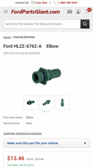

Those early years have a problematic PCV check the PCV valve and the system it sits in for a hold up of oil - also this elbow on the front valve cover is an issue here is the replacement part:
Green is a good newer fixed one - brown is old and might be clogged.
