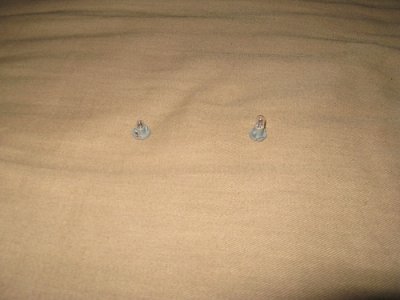

I'm pretty sure it takes the soft button EATC bulb. The bulb I'm talking about is the taller one in the picture. Just comparing the 2 bulbs, it looks like both bulbs may work in the clock.

My 2 cents worth...
I tried one of the hardbutton lamps out in a 92 clock I had laying around and everything fit correctly, good electrical connection. The hardbutton lamp is just shorter than the softbutton/clock lamp. In my opinion, the shorter lamp will do the trick nicely. Guess I need to rig up a power supply to that clock and give it a test drive!

Finally am back in the shop with time to play around and, yes the shorter hardbutton lamps will work fine in the 92 clock. I have a couple pics on my phone comparing them. Will post if anyone is interested...
The bulbs that I took out of a 94 EATC were the exact same as the bulbs in my 92 clock.

Already discussed earlier in this thread. Posts 14 and 21 confirm the bulb is the same as one from a softbutton unit.
FWIW the lamp base is technically called a neo-wedge base. this helps when searching for replacement lamps.

I got some bulbs from Mike (neo wedge base) from an older hardbutton unit and it fit right in my 89 clock and it works great.
