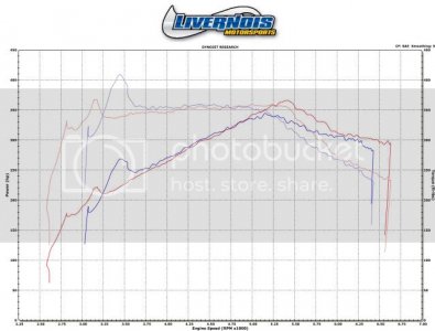

Everytime we run a SHO on the AWD dyno, the graphs look weird and always have a spike when you tip into the throttle and it skews the numbers.
Below is the graph showing stock vs. CAI and tune. There are areas where it picked up 100 WHP/WTQ
Shonovalues
Yesterday it was 102 degrees when the car was on the dyno. The down low numbers were close to the same/slightly lower, but after 5,000 RPMS there are areas it picked up 25+ WHP / WTQ.

The exhaust wont change anything Rick, the stock exhaust flows great from the flex pipes.. The restriction is in the down tubes. So if you want a corsa sound then spend the 1000.00 plus.. or just have a local exhaust Shop make you one..
the Down pipes are 1.75" that is where the restriction, coming out of the turbos its 3" a flex wont do anything but add sound.. research back to Sept of 2009 and you would see the data guys..

Kirk, it actually did pick up some power up top, from 5000+ rpm.

Rick are you locking it in gear? if not its a shift point of the converter.
