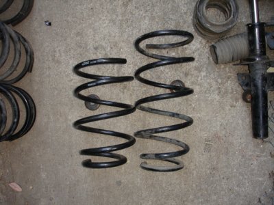

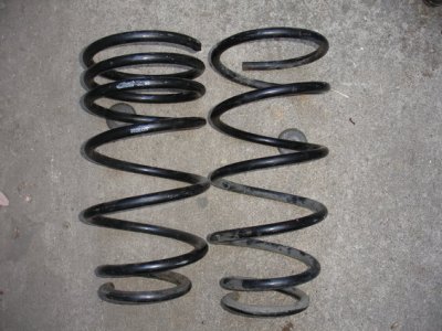

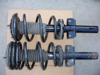

yes, cutting two coils on eibach will get you uncut intrax height.
I have intrax and eibach, and I just cut my eibachs today when I put on new struts.
eibach vs stock
Dsc06900
two coils cut
Dsc06911
cut eibach vs stock
Dsc06903
new strut with cut eibach (top), old strut and uncut eibach (bottom)
Dsc06908
1993MTXSHO
Its a Taurus...
Feb 3, 2006
4,720
330
Jersey
wow could you ask for anything better then those pictures to look at, sweet. Be carful how much you cut off, Since you got me interested I was reading and I read not to cut anymore then 2 coils off. Im thinking about cutting one because it looks like the eibach will still seat nice because of the way the coils are. Sounds like your in my position want it lower but not to low, id cut one coil. I Also read that some people said the handling sucked after cutting and they had probelems but I think that was with stock springs not aftermarket. Call eibach and ask them about cuting them. Also when yo cut make sure you dont use heat it will weaken the spring. A cutoff wheel is the best.:thumb:

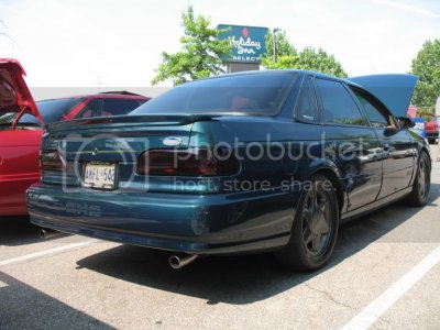

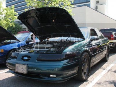

yeah Marcel your SHO is insanely good looking. It had a pretty nice ride when I was in it one of those days at the indiana convention.
Mine handles better now then it did, but I did put new struts in when I chopped mine. It's also about the same hight as Marcels from the pics. Not sure why mine is so high with two coils cut? :shrug:

Ishodu
Jun 26, 2002
5,077
615
Ontario Canada
Silver95 said:
Marcel was anything done to the rear springs?
Also, will the cutting of the dead coils effect ride quality or no?
All 4 corners a dead coil was removed. Ride quality wasn't changed that I noticed.
