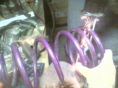

I couldn't stand it any longer.. ok ok, it wasn't actually planned. I was changing the front struts last night and when I saw the springs laying on the ground I saw the opportunity. Unlike the eibachs on my '95 that lost two I only took a coil off the intrax. I didn't have my camera with me so I snapped a few pics of the springs being cut with my phone.
Cutting intrax 1
Cutting intrax 2
one coil off each front
Dsc07268
the final product
Dsc07258
I didn't think about it.. I have a set of new eibachs assembled on struts in the garage, I should have pulled them apart to compare to the intrax before I cut them... ohhhwell :bonk:

If you cut two coils off the Eibach's they don't sit flat in the strut hats, and you get all kinds of rubbing noise from the spring seat rubbing on the strut tower. I wouldn't recommend taking more that 1 coil off.
Car looks great on Intrax with 1 coil cut.

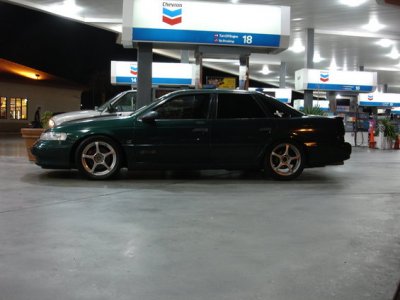

Full car pic.. I'll see if I can get another one, this was on my trip this weekend when we had the car loaded down, the rear was sitting 1/2" lower then usual.

how far do you think it lowered the car by cutting one full coil? 1 inch?? I put the koni intrax setup on my car and it seems like the front never lowered compared to stock.
