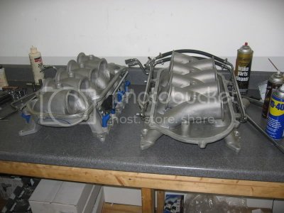

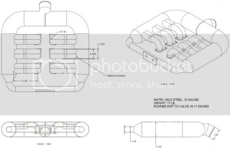

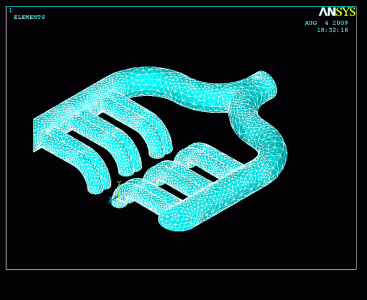

You got guts for attempting this, although I have a gen2, it took me four months working 5-6 hours a week, you can see it in my avatar.
Sho engine bay 10 16 09 zpstqqvosdw
I started with this concept
Intake concept 7 9
and taking a lot from the Boss 290 intake
2000 cobra r intake
I change it a little bit and ended up with this:
Intake new mesh zpsszagd1yz
we had a lengthy discussion here:
http://www.shoforum.com/index.php?threads/anyone-running-without-butterflies-plates.103665/page-3
The only thing I would do differently is just weld an inlet since mine was supercharged, no need to make a throttle body mount, if possible make the runners go across across but I couldn't do that since the whole idea was to close the hood.
