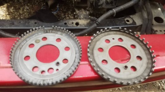

"Just a small update, got all my sensors and coils swapped over, the crankshaft trigger wheel does need to match the sensor it is designed for. The 2010 engine trigger wheel has less teeth, more spaces than the 2016 wheel. Got the converter seal and left axle seal changed. Got the engine and trans bolted back up and up in chassis. Found out 2010 flex plate has 4 holes, 2016 flex plate has 3 holes. Found this out when I went to bolt the converter. Dropped it back out. Swapped to correct flex plate. Reassembled and back up in chassis. Pulled the bumper, condenser, radiator and cac. Cac had some evidence of metal after I drained it of oil. Gonna bring it and the radiator to work Monday and flush it them out well. The new engine uses specialty orange, the old used specialty green. Going to do a complete flush without the thermostat to the cooling system to prevent cross contamination. Subframe is back up and top end is pretty buttoned up. Just need to replace the bank 2 wideband as the turbine whacked it when it broke. "

Kinda confirms this is likely my issue

unfortunately I cannot find details at the moment on exactly what the difference is, but will keep looking ...
On the threads that I link to above, I think he goes into detail about how the newer style has less teeth, which would explain why it's not firing any of the coils, it's counting the teeth going around after the gap and doesn't enough and then the Gap comes back so it never initiates a fire sequence
