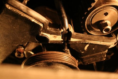

The wire coming out of the middle timing cover is the CKS (crankshaft position sensor) and it comes from behind the lower timing belt cover, then clips into the middle and then routes underneath the upper above the water pump.
Sho help cksrouting small
If it is not exiting out of that indentation then it should be fixed, as with all the rotating things around the results can be disastrous.
