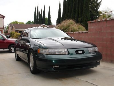

SHO Continental said:
I'm running mine no pins.. it's a little uneven though, but it's been tested to 130 with no problems.
Dsc15124
:salute: more the power to you, mine flew up at about 50 MPH on me, what group buy is yours from?

yeah tested in the wind tunnel at the ford research center. :thumb:
I didn't get it in any gb, this is the first of the new ones that come with a support in the cowl. got it last feb.
