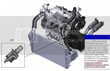

I did find out that the intercooler is in fact part of that whole package known as the Bolster-Integrated-Assembly which also houses the radiator, trans cooler and oil cooler. The intercooler is an air-to-air type. The plenum for the intercooler is on the very bottom of the BIA. The Charge Air Cooler (CAC) hose goes down from the throttle body to the top of the BIA.
