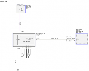

Hi. Slickdawg here. I have a 2010 sho and I am having trouble with the cooling fan. It runs after I turn the car off. Yesterday it did not turn off and ran the battery down so low the key fob would not work. Can anyone tell me where the relay is?

most likely will have to replace the assembly. common problem on older shos. on the 2.0 eb it is frequent for the fan relays to die and cause this issue.

I just had the exact same problem on my 2010 SHO. I was able to find a new Cooling Fan Control Module through Rock Auto and found a used one doing some online searching.
